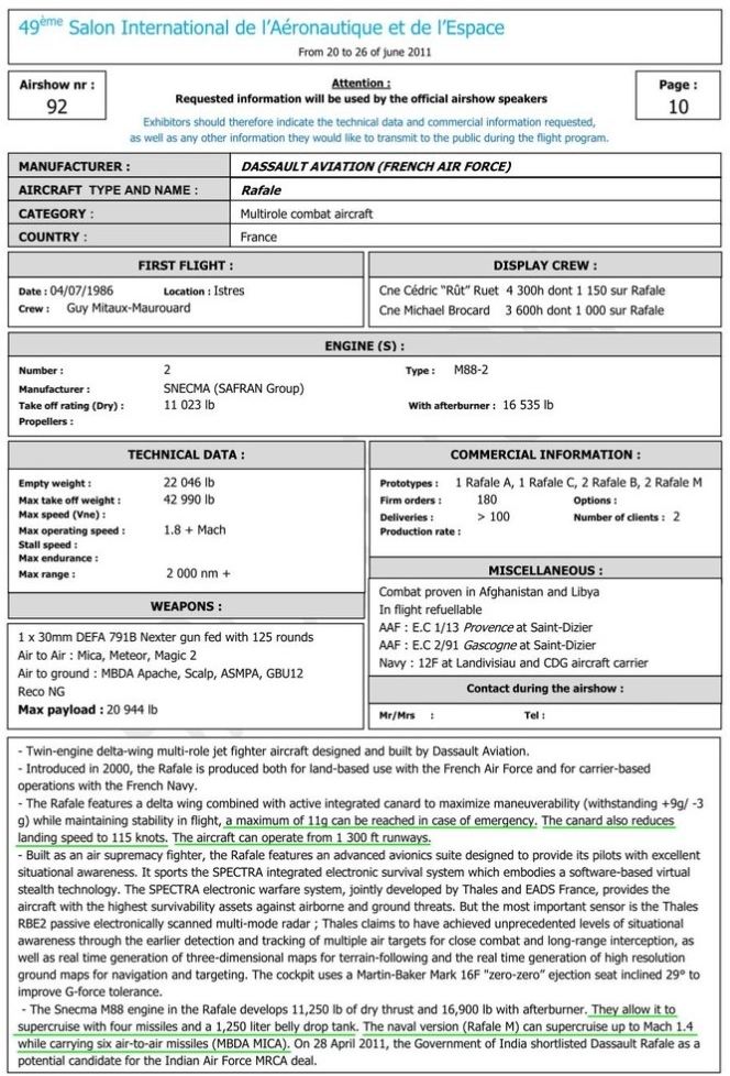

The Typhoon is not 2t heavier than a Rafale. A Rafale B weighs 33,000lb with fuel and a C is 1,000lb lighter. Fuel weight is 10,300lbs, giving 21,700lbs empty weight. Typhoon is 11t (24,200lbs) empty with 11,000lbs of fuel. This calculates to a TWR of 1.15 for the Typhoon and 1.06 for the Rafale, although BAE quote 1.2+ for the Typhoon largely because the engine thrust rating is highly conservative.
https://www.baesystems.com/en-be/download-en-be/20180131111003/1434587164305.pdf
This why the Typhoon got a 9 for performance and the Rafale a 7.
The Typhoon is not 2t heavier than a Rafale. A Rafale B weighs 33,000lb with fuel and a C is 1,000lb lighter. Fuel weight is 10,300lbs, giving 21,700lbs empty weight. Typhoon is 11t (24,200lbs) empty with 11,000lbs of fuel. This why the Typhoon got a 9 for performance and the Rafale a 7.

Wing loading is also important. Typhoon - 63.9lb/ft2, Rafale C - 65lb/ft2.

For god's sake, use non after burner thrust, not the top thrust for calculating supercruise. Super cruise is without after burner
