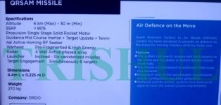

If we had the dimensions/weight comparison of QR-SAM, VL-SR SAM and Akash NG rounds, we will be able to draw some rough estimates.

Considering the figure 14km altitude is correct in the poster, I feel something like 50km should be easily possible.
And becoz it's dual pulse, expecting 70km range isn't wrong too.
(I am thinking that the effective envelope of a missile should be some sort of spherical shape. So if a QR SAM with solid motor is advertised for 30km range and 6 km altitude, a heavier Akash NG with a dual pulse motor.... )

For what's it worth I find it hard to believe Akash ng range is 30km
If someone wants to compare the length and width of Akash NG with MRSAM
If more or less same or even with 10-20% less
And assuming fuel used / fuel grain configuration is same ( no reason to be otherwise)
And given it's 2 pulse ie boost coast boost
And say Akash NG is not spending time in coast phase , ie all the way powered flight
Even than it's range IMO will be bet 30-50
