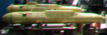

Walchand Industries provided the following list of equipment for a BARC designed "mobile reactor":
They are obviously talking about BARC's CLWR-B1 reactor that powers the Arihant class SSBNs. They have also supplied to BARC this 1.1m dia high strength spherical vessel:
This is probably the lock-out door that separates the reactor from the rest of the propulsion machinery. Walchand also produced & supplied the 9m dia pressure vessel that encloses the propulsion unit (reactor + turbomachinery):
This is the same vessel that we can see here on the land-based CLWR-B1 reactor:
The propulsion vessel is 9m in diameter. The whole sub is 15m in diameter. Arihant class has the typical Soviet/Russian double hull design. Also, publicly available info says that Arihant class subs can dive to a depth of 300m. Water pressure at 300m would be around 30 bars. This pressure vessel is rated to survive 70 bars of pressure.

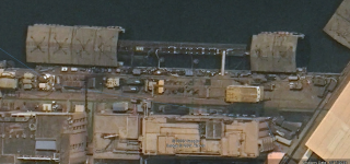

Say in future, can they launch a marinised version of A1P of 1190mm dia , maybe slightly less for the SLBM and multi packed in the bigger generation subs (S5 and above). Obviously its probably a century away almost, but the actual SSBN classes would continue to be upscaled? Arihant the ATV with 4 silo to finally reaching 16 silos at a later gen of SSBN. Then the silo tube dia becomes higher to accommodate future very long range systems as well as multipacking smaller missile classes?
It's easy. The S5 is a 12,000+ ton class SSBN that will require more space to build. Future SSNs will be of the current Arihant size (around 6000 tons). Therefore, the current facility at SBC will be used for SSNs, and a new facility will be used for SSBNs.Seen people claim its for SSN, some say SSBN
