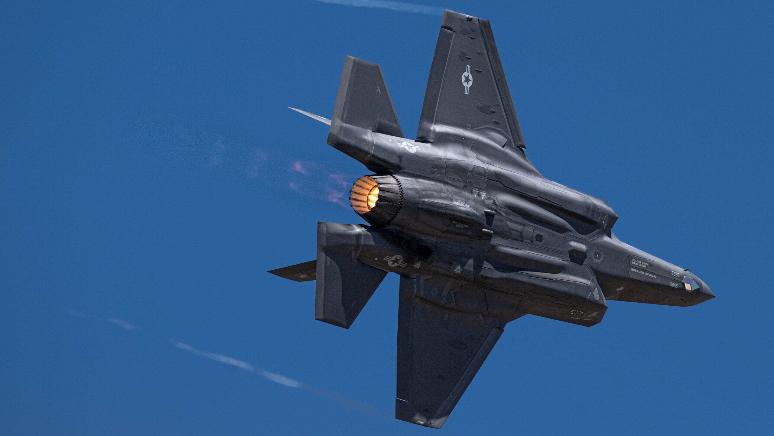

Question for those more knowledgeable, why has the flyaway costs of the Rafale inflated over the years versus the F-35? It seems that Dassault has not benefited as much as LM from having a healthy order book?
I do understand that the F-35 is a much larger project and benefits from economies of scale to a far greater degree... but there is also a greater degree of foreign components and manufacturing in the F-35 versus the Rafale. Is France just more affected by inflation?
