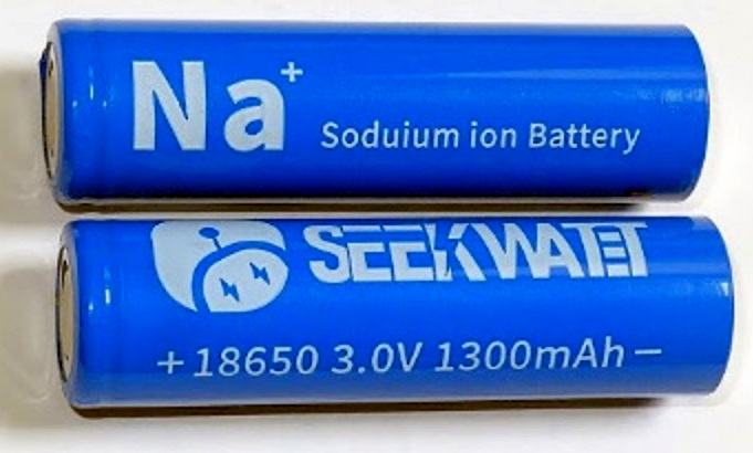

Yeah. But we need to wait for Jap, SoKo and Western sources to claim that. Chinese claims are just for lols.
Nevertheless, Na is gonna be more important long term for cheap vehicles. But the problem is they have a lower energy density and lower cycle times, pretty much half. It's mainly suitable for cheap low-cost cars and lower that don't require as much range on a daily basis, and for storage where size and weight are not a concern. The plan in India is to make it swappable. You drive over to a gas station on a two-wheeler and swap it out for a new battery.
Only the battery is cheaper to make, at the cost of efficiency, so it still does not beat H2's "overall" cost to the consumer. Because it all comes down to the cost of electricity. With Na, your car's gonna be cheaper to buy, but would require more electricity to run, and it still won't be cheaper to buy than a H2 car with its small simple fuel cell.

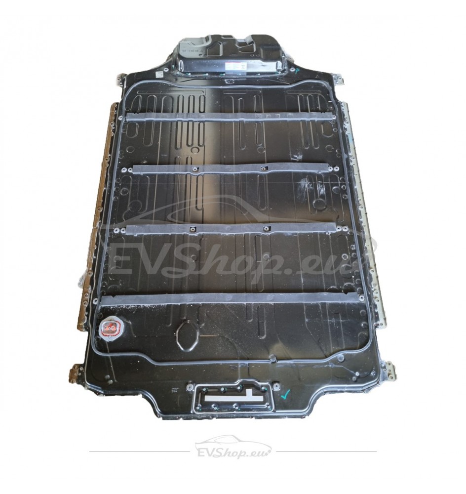

These batteries weigh several hundred kg.

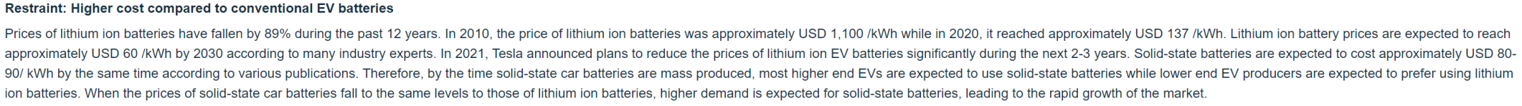

Solid state batteries will last 4-5 times longer than existing Li batteries too. 2,000-3000 cycles wil become 10,000-12,500 cycles. basically the entire lifetime of a car and more.
Na batteries last about twice as long at 5,000 cycles.
Then it's cheaper to use the same 133-143kWh to charge a battery as well.

Na has a short cycle life, you can't keep recharing it as long as Li. At least half. Which is why it's good for small vehicles that need low power, especially the swappable kind.
5,000 cycles says otherwise, it's only beaten by solid state Li.
Solid state is fine in terms of life, good for phones and laptops, but seriously expensive for cars. It costs $800/kWh vs $140/kWh for Li. It's never gonna be cost competitive for your average car. Only the rich can afford it.

Even a Tesla Model S Plaid battery is only 479kg, Lucid Air Dream 460kg. Fuel cells have a shorter lifecycle based on what I'm reading, certainly none that have managed 310,000 miles.

You wanna match the range of H2 over time, you're gonna need a 1 ton Li-ion battery. A Tesla 3 apparently gives 12kWh/100km, at its most efficient. So to get to Mirai's most efficient 1000 km range, it needs 120 kWh. Such a battery is in the 1000 kg class. Tesla's new 100 kWh battery weighs nearly 700 kg. Regardless, 500 kg vs 56 kg, no competition.
