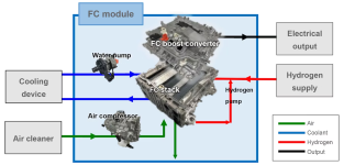

Mirai's fuel cell stack weighs 56 kg. 240 kg is for everything; air and hydrogen supply, cooling and power control.

No 240kg is the fuel cell module weight, where in that picture did you see the two H2 tanks? the hydrogen supply is coming externally. It doesn't include the Li battery they still use either - yes the Mirai still uses an Li ion battery anyway, see post above.
The Mirai's output is 114kW, the fuel cell module only makes 80kW alone (see link in previous post), so no, it is needed to make the full power. And by the way, 114kW in a car weighing 1850kg will be a sluggish pig.

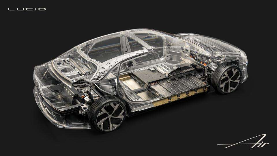

The Lucid Air Dream has 516 miles range, that's 825km catalogue value, 460kg battery. The catalogue value of the Mirai is only 650km, with a powerplant that only offers a tiny fraction of the power.

It is the entire module. The energy part is only the fuel stack that requires battery-related recycling, and that weighs 56 kg. It comes with air and H2 supply, not the H2 cylinder. And power control. And yes, FCEVs have Li-ion, but it's purely for low speed, braking and acceleration related tasks, and needs 100 times less supply of Li. So it can all be made for cheap 'cause pretty much everything is manufactured, not simply mined at exhorbitant cost.

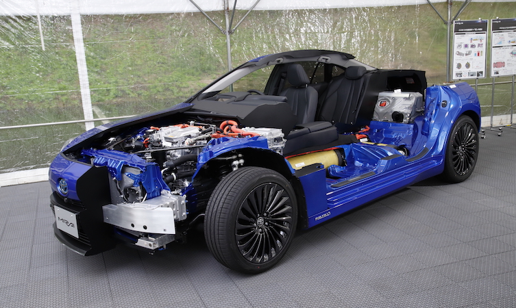

There are two H2 tanks weighing 87.5kg not in that picture.
The new one has 3 tanks, so even more weight - 131.25kg - to hold this 5.6kg of green H2 that takes 392kWh of electricity to produce and compress, enough energy to fully recharge 4 Tesla Model S, oh but wait, you still have a battery to recharge even after all that.:ROFLMAO:
Crucially, the adoption of the new GA-L platform has enabled the fitment of a third high-pressure hydrogen fuel tank.

This is getting dumb. So what if there are 3 tanks? The fuel cell stack is the same. It's just 56 kg vs 500-900 kg of Li-ion. It's obvious which one has a more expensive replacement and recycling expenditure. But damn, a third tank adds to the range. What about a 4th one? So for nearly 180 kg, I can do 2000 km on a single charge? Does Li-ion have such an option, just keep increasing the battery packs at 500 kg a pop? Why do all your arguments end up supporting mine instead?

The tanks weigh 87.5kg for 2 tanks and presumably 100+kg for 3, and you only get 114kW, but you need a 45kg Li battery for the other 34kW. It does 650km catalogue value (Under the skin of the new Mirai), A Lucid Air Dream does 520miles (837km), battery weighs 458.7kg and it has 1,111hp (828kW) and the same 120kWh capacity as the Mirai. Furthermore there is now a Drem Edition R that does 900km and still has 696kW of power and manages 13.12kWh/100km, vs 70kWh per kg of compressed H2 to do the same 100km.
