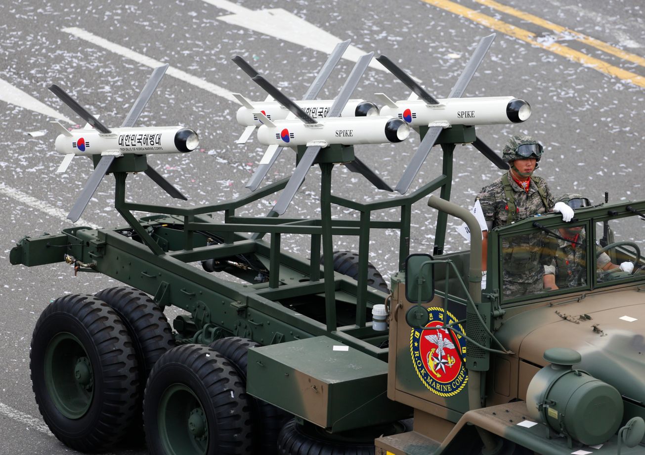

Here is a brief comparison between Spike development and Indian Nag development :
Main Source
Spike :
1. Need Felt after 1973 conflict with tank columns rolling onto Israel.
2. By 1981 Tammuz (Spike-NLOS) was operational with Pereh vehicle. This was first surface to surface use of TV-Guided missile. It was so successful that even UK, Germany and South Korea imported it in both ATGM and anti artillery roles.
Nag:
1. Design started in 1988. First tested in 1990.
2. Till date neither Nag nor NAMICA has entered production. NO variant of Nag (AFAIK) are operational. No export made, obviously.
Spike :
1. In 1992, Spike MR was tested for first time.
2. In 2000, Spike MR was exported to Finland.
Nag :
1. In 2018, MPATAGM was tested.
2. Devil knows when it will see any induction. Lets not even talk about export.
Spike:
1. In 2010, Spike ER was imported by italy for use on A129 helicopters.
Helina:
2. Till 2020, HELINA/Dhruvastra is still not operational after devil knows how many tests. HELINA's range is also less than Spike.
