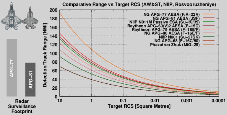

This graph shows that for 1 m^2 the AN/APG-81 has a range of 80 NM, or 148 km.

Against 1m2:
APG-66 detection range is 68Km.
APG-68 = 80Km
RBE2 PESA = 80Km
RBE2-AA = 106Km
APG-83 = 116Km
Bars-1 = 126Km
Uttam Mk1 = 126Km design goal
APG-80 = 132Km
KLJ-7A V2 (Type 1478) = 134Km
APG-79 = 150Km
Irbis-E = 151Km
APG-81 = 148Km for now... Could cross 200Km with the TR-3 upgrade.
RBE2 AESA = 160Km... Double that of PESA, as per advertisement.
APG-77 = 255(?)Km
May not have the same detection probability.
