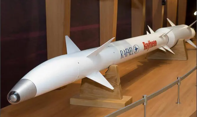

Missile dimensions are best used for analysis. It rarely goes wrong.
Derby is 3.6m long, has a diameter of 160mm and is advertised to have a range of 50Km.
MICA is 3.1m, 160mm dia, is advertised to have a range of 80Km.
RVV-AE is 3.6m long, 200mm dia, is advertised to have a range of 80Km.
No longer computes. Hence we can estimate the range figures by bringing in other reasons. RVV-AE and MICA-RF have the same range even though the MICA is obviously so much smaller is entirely due to the massive technological difference. The Russians half-assed an export grade missile that they themselves didn't induct. Naturally, Derby's lower range is more due to altitude it was measured at than anything else, and the Israelis did not half-*censored* the design. So MICA and RVV-AE were measured at high altitude, Derby was measured at medium altitude. Hence different figures.
So for the 100 KM Dual pulse motor tests by which Rafael established this medium-altitude range, there surely will be some data to compare it to the corresponding ranges for Astra, RVV-AE, Aim 120, Meteor?
The Aim-120C is merely 20% bigger than the Derby in volume. The tech base is the same. So how is the Derby magically less than half the range of the Aim-120? Obviously doesn't make sense. The Aim-120D is also the same size as the Aim-120C, but does 3 times the range, again, doesn't give the Derby the credit it's due. Hence not an apples to apples comparison.
What you have assumed is the Derby was created from the Python, so it has the same range as the Python. Obviously wrong analysis.
Naturally, the Israelis are not dumb enough to claim without any rhyme or reason that the 150-180Km Aim-120D is only 50% as capable as the Derby ER. Range isn't the only factor in their calculation obviously, but it's not out of the ordinary to expect it to at least match the range, if not exceed it.
Also you can easily extrapolate. The French claim the MICA NG will have twice the range of the MICA. Hence you can estimate it as 160Km. Considering the dimensions and a similar tech base, the Derby ER that's 400mm longer than the MICA, is gonna be above 160Km, closer to 200Km. Possibly more than that, since the Israelis have removed the fuse from the original Derby and combined the seeker and fuse into one unit on the Derby ER. That gives us a whole lot more space for a more powerful motor and extra fuel. Even if the Israelis suck and have managed the same range as the MICA, it's still far more than Astra Mk1, Aim-120C or RVV-SD.
Astra was designed to do 44Km at medium altitude and 80Km at high. But during tests, it killed a drone from 50Km away at medium altitude, which is similar to the performance of the Aim-120C. So for the Derby at merely 20% smaller than the Aim-120, but with 20% lighter weight, it's more than likely that the 50Km range is at medium altitude, which means it will equal the Aim-120C at high altitude.
Dimensions never lie when the tech base is more or less the same.

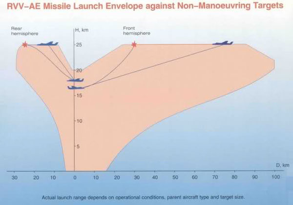

As I've pointed out early on, the Aim-120 drops significantly in range at lower altitude. But the drop for the MICA is much less pronounced, since it was made to operate at lower altitudes more effectively than its bigger and heavier counterparts. Hence the shorter, smaller, less draggy design, with bigger fins and greater lift, and pulls more Gs, suitable for greater air density environments. Similarly, the Israelis designed the Derby around the Python thereby retaining some of the low altitude advantages. But they didn't go the whole hog like the French, and decided to increase the length so that it is a half-way missile, capable of doing adequately well at low altitude and at medium/high altitude. Otoh, the Aim-120 and RVV-AE were designed specifically for the medium to high altitudes. Many missiles have been designed around different combat philosophies, which is why the ASRAAM cannot turn like the IRIS-T, but can burn much longer. And in order to complement the low altitude capabilities of the MICA, the French have added the high altitude capabilities of the Meteor.
This brings us to tactics. Air combat is not 1v1. 1v1 happens when your whole team is dead, or when it has training value. Air combat is about groups and teams and involves team work. Take the example of the French. If you put the MICA up against the Aim-120D at medium to high altitude, the MICA will lose, obviously. The French state it so unabashedly. So you have to consider team effort, where the French will send one team out at a lower altitude for an air strike thereby making use of the low altitude advantage of the MICA, while another team engages the enemy at high altitude with Meteors. With Rafale, M2000, Mig-29, MWF and MKI, we get much greater options than the French do.

The numbers I have extrapolated:
RVV-AE's ranges are 35-45Km at medium altitude and 80-90Km at high altitude.
Derby's ranges are 50Km at medium altitude and 100+Km at high altitude.
Astra Mk1's ranges are 50Km at medium altitude and 100+Km at high altitude.
MICA's ranges are XX Km at medium altitude and 80Km at high altitude.
Derby ER's ranges are advertised as 100Km at medium altitude and XXX Km at high altitude.
What is Medium and High altitude defined as: why is there a 50% derate?
I am not disputing the 80Km range of both RVV-AE and MICA. What I'm asking is how a 3.1mx160mm missile has the same range as a 3.6mx200mm missile? Why is a missile designed to be agile have the same range as a much larger missile that's been designed for speed and range?

Here's one more suitable for the subject.
You can see it drop from 80Km at high altitude to 40Km at medium altitude. And then to 20Km at low altitude. This gives you the 50% drop rule of thumb.
