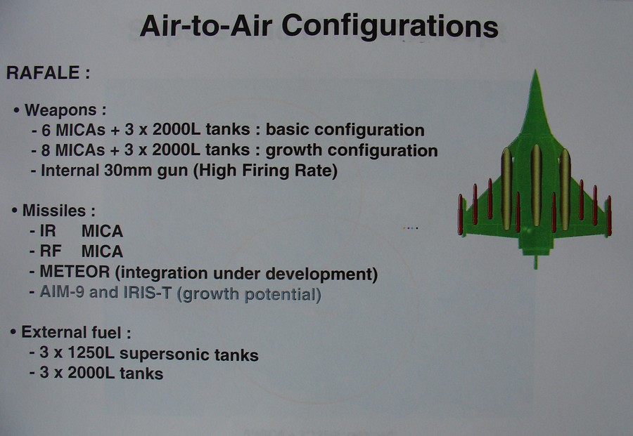

Air - air missions
This is the range given for the Rafale in air-to-air missions at high speeds. The payload is six (currently ten with the alternative option of four being METEOR) MICA missiles and two 1250 litre RPL-711 supersonic fuel tanks in this very old illustration. With the same fuel tanks today (below) the Rafale F3-R can carry up to 10 MICA EM/IR missiles or four METEOR and six MICA EM/IR.
The 225 nautical mile combat radius depicted above in a high-speed air-to-air role can be almost doubled with this configuration. Eight MICA EM/IR or four METEOR and an equal number of MICA EM/IR with three external subsonic RPL-751 fuel tanks of 2000 litres capacity (each). Under this configuration and with a load of METEOR missiles (and from the F4 and MICA NG configuration), the Rafale will be able to patrol, strike enemy fighters from distances of more than 100 km and guide friendly fighters, staying out of range of the Turkish S-400s.

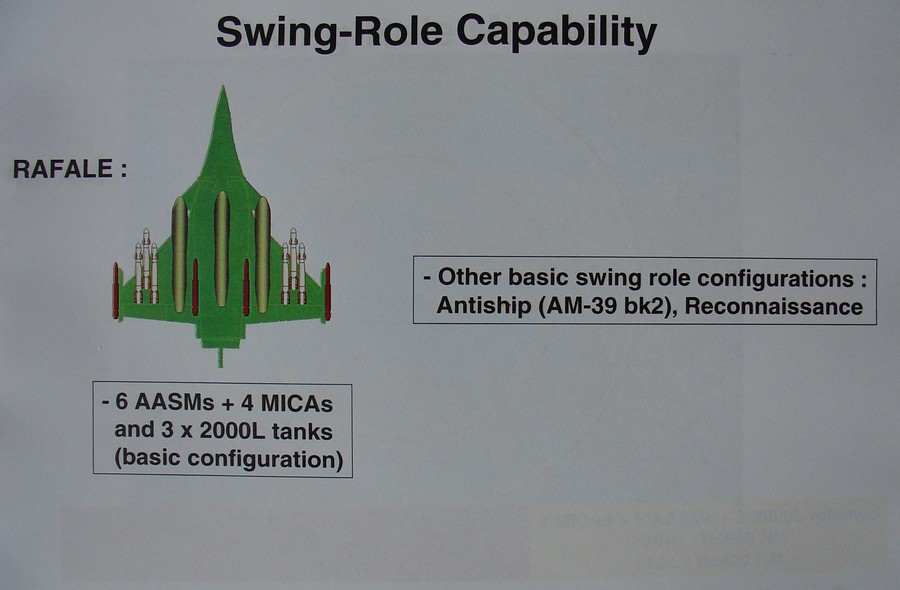

[img][URL='https://www.dropbox.com/s/t3ept9kjhfdp9rl/Swing-role-capability-768x503.jpg?dl=0%5B/img']https://www.dropbox.com/s/t3ept9kjhfdp9rl/Swing-role-capability-768x503.jpg?dl=0[/img[/URL]]
[img][URL='https://www.dropbox.com/s/231j0bkk1ywmokx/Swing-role-photo-768x451.jpg?dl=0%5B/img']https://www.dropbox.com/s/231j0bkk1ywmokx/Swing-role-photo-768x451.jpg?dl=0[/img[/URL]]

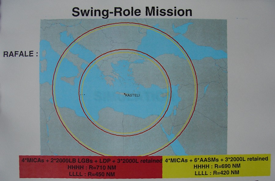

The illustration shows the fuel and weapon load configuration for swing role missions, with what was included many years ago. Namely three 2000 litre RPL-751 fuel tanks, six AASM (HAMMER) and four MICA EM/IR. The photo below shows the swing role cargo configuration as it is today. With six air-to-air missiles that are either MICA EM/IR, or two METEOR and six MICA EM/IR. Alternatively, LGBs can be carried in place of the AASMs as well as a targeting nacelle.
[img][URL='https://www.dropbox.com/s/htc52d8amlwk15s/Swing-role-configuration-768x506.jpg?dl=0%5B/img']https://www.dropbox.com/s/htc52d8amlwk15s/Swing-role-configuration-768x506.jpg?dl=0[/img[/URL]]
Illustration of the Rafale's combat radius, with swing role load configuration (it used to be as described in the illustration and now as in the photo (above) with two additional air-to-air missiles and the alternative of two of them being METEOR. The large circle depicts the combat radius with Hi-Hi-Hi flight profile (at medium and high altitudes). The small one depicts the combat radius with a Lo-Lo-Lo flight profile (low to avoid detection by enemy air defenses).

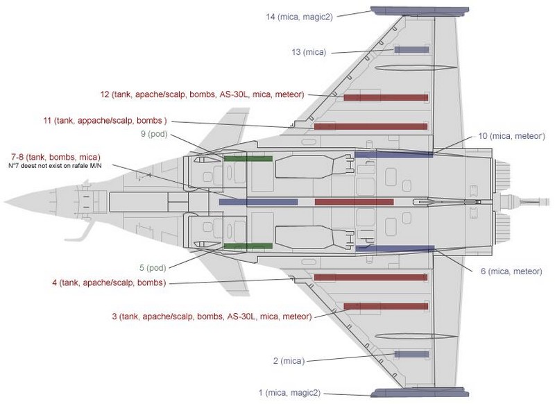

[img][URL='https://www.dropbox.com/s/loejxe3rbmwei8i/External-stores-configuration-768x559.jpg?dl=0%5B/img']https://www.dropbox.com/s/loejxe3rbmwei8i/External-stores-configuration-768x559.jpg?dl=0[/img[/URL]]

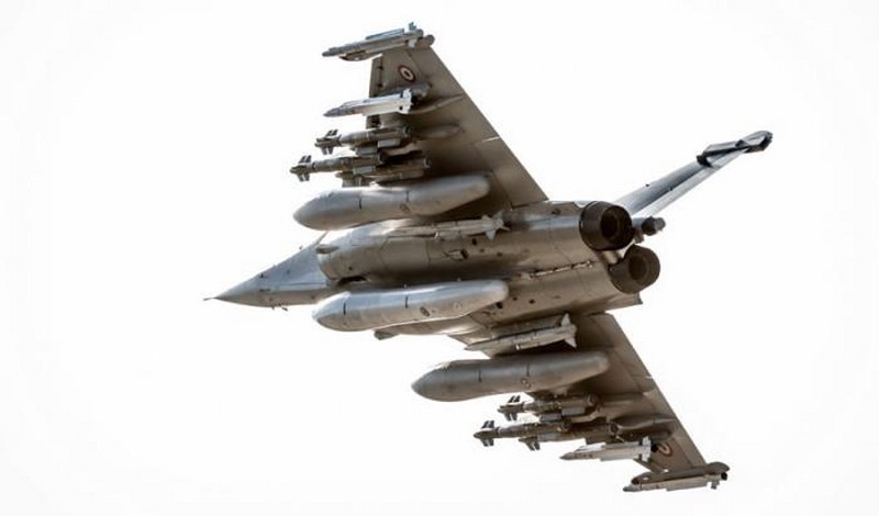

We conclude with this extremely informative illustration. To which Rafale cargo hanger stations, what can be carried. Those that can accept external fuel tanks (wet) are shown in red. The Super Hornet and MiG-35 have as many wet stations, but the former has only 11 cargo suspension stations (compared to 14 on the Rafale) and the latter only nine!

- Air - air shipments
This is the radius given to the Rafale in high-speed air-to-air missions. The payload is six (currently ten with the option of four being METEOR) MICA missiles and two 1250-liter RPL-711 supersonic fuel tanks in this very old display. With the same fuel tanks today (below) the Rafale F3-R can carry up to 10 MICA EM / IR missiles or four METEORs and six MICA EM / IRs.
The battle radius of 225 nautical miles depicted above in an air-to-air role at high speeds can be almost doubled with this configuration. Eight MICA EM / IRs or four METEORs and an equal number of MICA EM / IRs with three external sound tanks RPL-751 with a capacity of 2000 liters (each). Under this configuration and with a load of METEOR missiles (both from the F4 and MICA NG configurations), the Rafale will be able to patrol, strike enemy fighters from distances greater than 100 km and guide friendly fighters, staying out of range of Turkish S -400.

- Double role (swing) missions (air-air and air-ground / surface)
The illustration shows the configuration of fuel cargo and weapons for parallel - dual role missions (swing role), with what it included many years ago. That is, three 2000 liter RPL-751 fuel tanks, six AASM (HAMMER) and four MICA EM / IR. The photo below shows the swing role load configuration, as it is today. With six air-to-air missiles that are either MICA EM / IR, or two METEOR and six MICA EM / IR. Alternatively, LGBs as well as a targeting fuse can be transferred to the AASM site.
Illustration of the Rafale battle radius, with swing role load configuration (it used to be as described in the illustration and today as in the photo (above) with two additional air-to-air missiles and the alternative two of them being METEOR. battle profile with Hi-Hi-Hi flight profile (in medium and high altitudes).

We close with this extremely informative display. Which Rafale cargo stations can transport what. Red indicates those that can accept external fuel tanks (wet). The Super Hornet and MiG-35 also have so many wet stations. The first, however, has only 11 cargo suspension stations (compared to Rafale's 14) and the second only nine!
