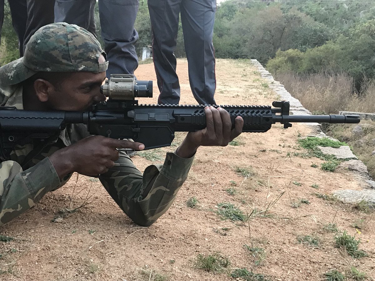

Andhra Pradesh Police unit (I think could be ATS, not sure) with SIG 716G1 -
Reactions: Maximus
1.Does this have a full length P-rail or standard INSAS type jugaad rail?
2. Which Magazine has this piece been taken, do post the link?
It should have P -rail as it seem to be divided into upper and lower,instead of a hinged dust cover.Although it is hard to confirm from this pic,as the charging handle latch cover the view.
The rifle is not Sig Sauer 716 Patrol Gen 1 but the Colt 901 :
Here is the Sig Sauer 716 Patrol Gen 1 rifle :
Reactions: Parthu

Hmm. Thanks
Isn't the rail under the handguard too small?
Or the handguard is removable like the galil ace?
This is taken from Sandeep unnithan column from Mail today.Here is the whole piece.
Here is the link
Yep, it's a Colt. Should've checked and compared the gas block before going with whatever Shatrujeet said. :p
Hmm. Thanks

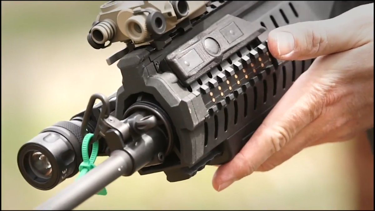

Can't say just from the pic ,whether it has rail beneath the hand guard or not.However,I have made a detailed post about this carbine ,please go through it.I have mentioned there that much better Hand guard design were available today,and such small rail is an ergonomic issue.
This rail arrangement and handguard do remind me of the mciws ,maybe same designer involved.

This is how it used to look with Keymod handguard Previously :
I am very pleased about the value being offered in this deal,hope Army goes ahead with a new deal for more such rifles.

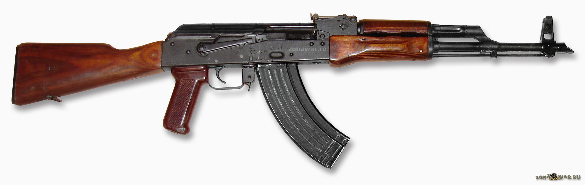

Original layout of AKM
OFB take on AKM
SS-lMT take on AKM

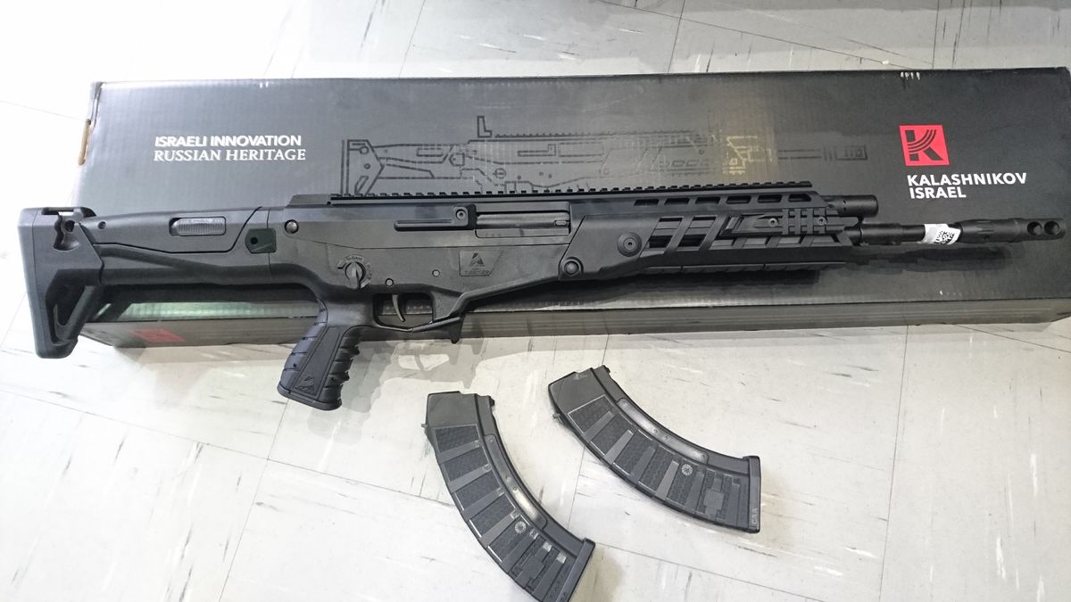

modern Israeli take on AKM
The lack of vision, passion,innovation and R&D in the OFB product is clearly visible.

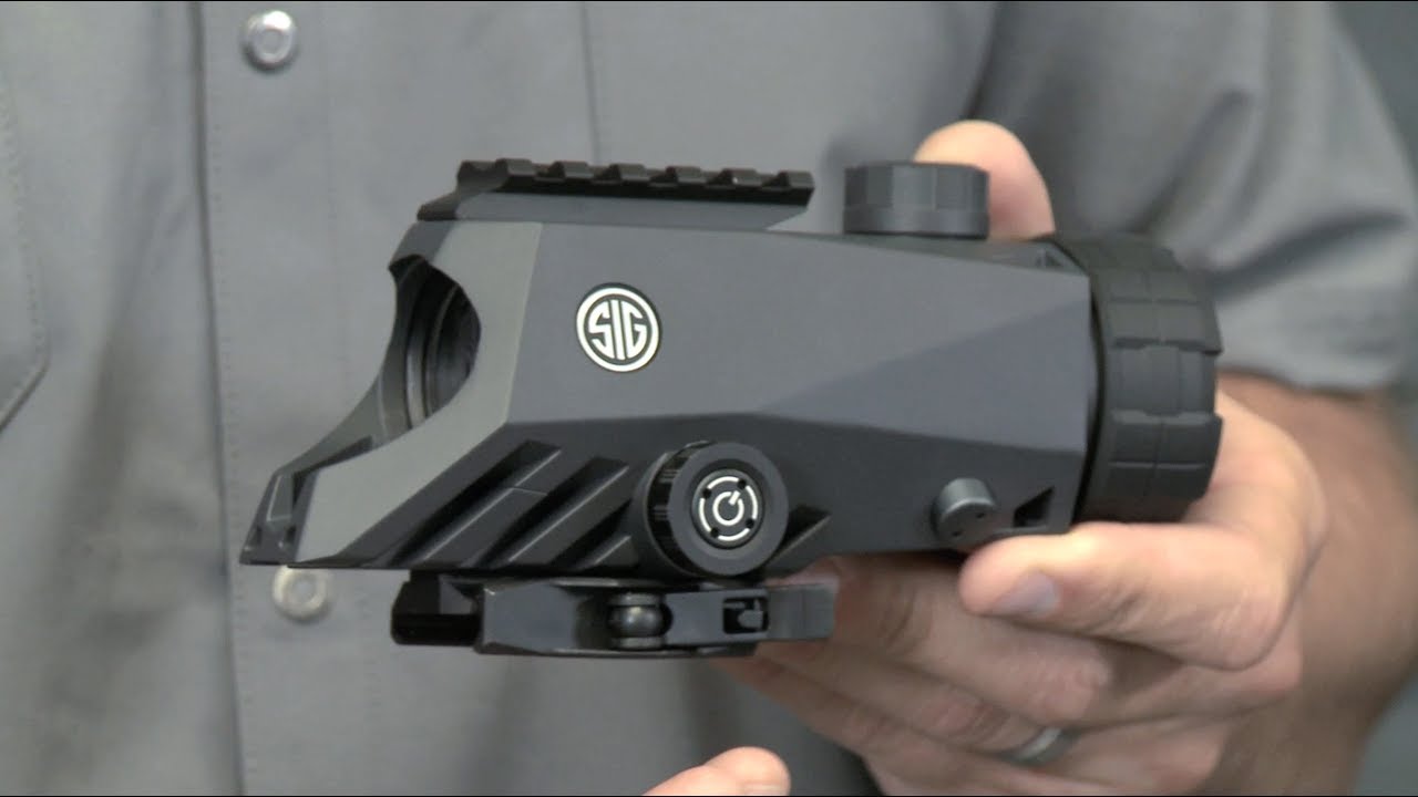

Talking of optics ,I feel a simple red dot sight will be a great injustice to a 7.62x51mm ar 10 rifle.To fully exploit its capabilities, you need a scope with some magnification for medium range and a micro red dot for CQB :
Yes...which means the BRAVO series optics from SIG may have been included (any magnifier is really expensive piece of kit, and a 4x SIG magnifier retails for almost $1200 MSRP!) -

Some new tech I've been watching;
Intelligent Rail ............ I see a lot of potential for this in future. As weapons (especially Special Forces-operated ones) get more and more electronic items on board (which would no doubt include shot-counter inventory management chips, biometric sensors, course-correction software, integrated ballistics computers etc. in foreseeable future), I think it might be a good idea to provide an integrated battery pack in the stock, and use of the rails as a power-delivery system.
Adopting of such a technology (which is already being studied by the US military) might lead to the creation of electronic accessories like lasers, flashlights, illuminated optics (and futuristic stuff of the type mentioned above) that are lighter & much more compact (as they'd no longer be needed to carry their own batteries).
This could also be a step toward adopting of a single, universally compatible power pack to be carried on the person of a future infantryman/SF operator...
Check out the company involved (T-WORX) here: Intelligent Rail® – Tworx

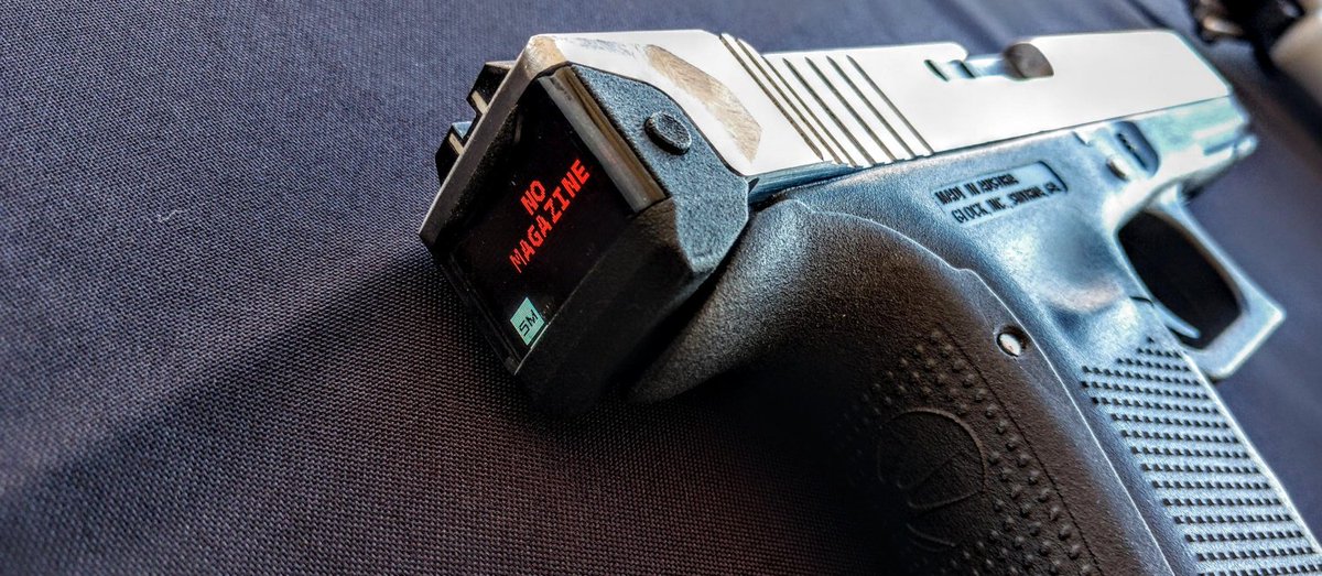

Radetec SmartSlide (aftermarket component for Glock pistols)
This is more of a novelty right now than a truly sought-after game changer....but for some reason, I foresee things like this becoming stuff that would be required by law to be present on the weapon, especially in civilian markets in the West in the not too distant future. And in the distant future, things like this would probably be integral to firearms in all walks of life. But till then, it remains a piece of cool engineering -
