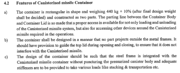

I don't know if that tender got retracted or not (they sometimes do) but this one is from today. There are some interesting things in it, mainly the redesigned VLS with the plume deflector. Remember the old module of 8 cell ? now imagine round canister shaped 4 more holes/pipes in between the missile canisters, total in 4-4-4 formation, that is the new design. Its kinda worse. Restricted docs hence could not.
Can you share just the image of the launcher?
No the doc was R&DE property & marked restricted so only saw in part. Just imagine fitting 4 round holes fitted in between the 4 missile launch tubes for plume to be released and you can get a good idea. 4 of those holes , 2 each are sealed with caps ie 2 caps. For missile firing , 2 caps open, missile fired in succession maybe and plume goes out. Entire unit ie 8 missiles set is about 5 meter in height, about 3 meter length and just over 2m in width.
