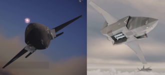

We see that IWBs of both F-22 & Su-57 have some disadvantage.
Su-57 carries only 4 AAMs currently, may be 6 in future.
F-22 cannot carry weapon bigger than JDAM currently. MLU might add something.
Su-57 can carry cruise missle, Kh-58UShKE internally.
A bigger collage shows some current weapons fit, some don't.
A new jet can combine both capability by having multiple IWBs. the centerline IWB will carry customized CrM, AShM, ARM, etc.
And 2 parallel IWBs can carry 2 AAMs each, total 4.
If we imagine a modified diagram of Su-57 & F-22 then it would look like following:
NOTE - This is just preliminary & notional, otherwise the engines & internal components will obviously have to be adjusted.
The following is 1 of the many examples already created by CAD artist Rodrigo Avella in his vision of F/A-XX :
The IWB bottom edge would be wider than F-22.

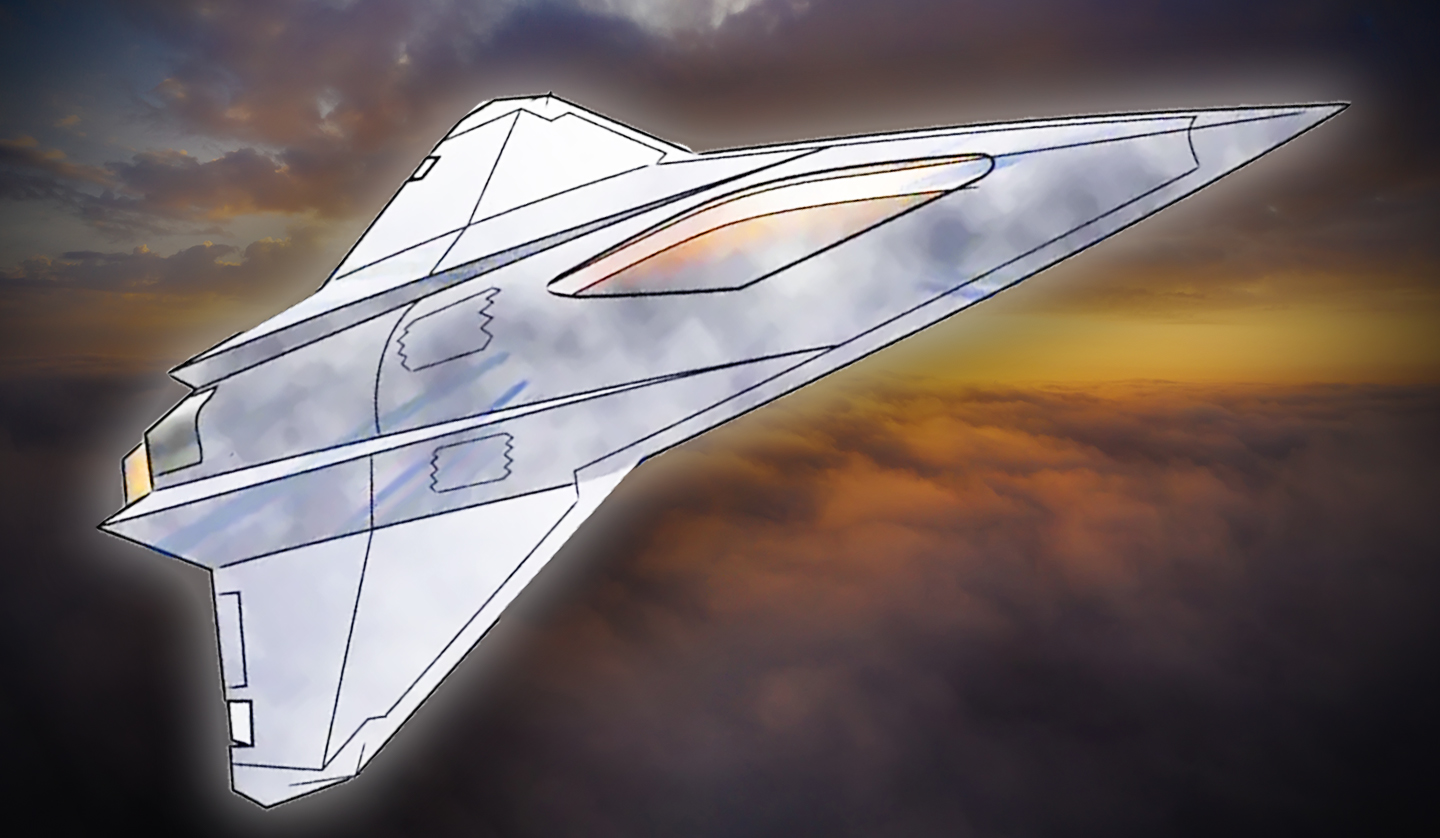

Today they are planning to increase internal payload by compacting other components, but also realizing that to maintain TWR better engines are required, hence R&D on XA-100/101/102/103 which will be bigger & heavier than F119 & F135 engines.
Now they can create FB-22 in form of NGAD, F/A-XX to be multi-role. Below is combo of 2 pics edited to show notional size comparison.

Anyway, it's possible that the USAF has decreased their requirements for NGAD.
After originally stating this very advanced aircraft that would sit as the centerpiece of the NGAD family of systems would cost roughly three times that of a new F-35 (upwards of $300M plus each), Air Force Secretary Frank Kendall is now eying pursuing a far less expensive aircraft, one that will cost around what a fresh F-35 or F-15EX does, which is very roughly around $90M-$100M apiece.
While the USN is going ahead with a simpler 6th gen design without any capability for air superiority and SEAD/DEAD.
So the USAF and USN seem to be doing exactly what I've been saying. The USAF could curtail NGAD and focus on a 7th gen jet. And the USN will go for a simpler 6th gen jet. Exactly the same as what I've said IAF and IN should do. Interesting, eh?
The reason being we do not need a jet better than AMCA that's limited to 18 km altitude. By 2050, if we modernize AMCA, it will be enough. The IAF needs to jump straight to 7th gen after AMCA for 2055. It's also why Dassault believes Rafale is sufficient until 2050. Drones, baby. You want more range, more payload, bigger sensors, you can make role-specific drones that can operate at higher red lines than manned fighters.
The USAF will apparently study what to do the next 2 years, whether to limit NGAD to $100M or go for the $300M version. And by then it's possible we will see the contours of the first near-space fighter in the form of the Mig-41, this will give us civvies a clue about what 7th gen will start looking like.
