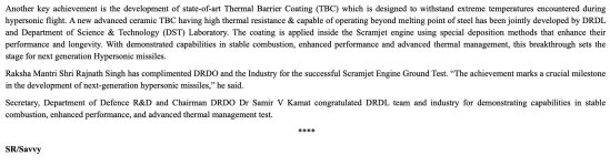

Next gen TBC validated by the DRDL for the Scramjet Engine:
