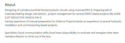

What missile(s) could you think of that could be similar?
Unrelated (ie different personal profile) but depending on work timeline & specifics, likely the R series or brahmos?
