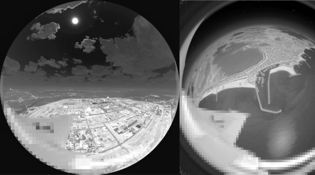

It should be noted that these images are taken from a film presented by MBDA some time ago. Observe the shape of the sun, very round: this implies that the sensor is very difficult to saturate and has very low remanence (otherwise we would see a trail at the location of the sun).
So what is the matrix sensor allowing images of such quality? It is likely that this sensor comes from the French infrared matrix sector SOFRADIR.
Brazilian news agency Defesanet has published a very comprehensive test of the Rafale B301 (Dassault’s “experimental” aircraft) in its latest configuration by test pilot Vianney Riller Jr. During this test, he describes a simulated launch with the target located at his six o’clock (behind him) of a MICA missile, using ONLY SPECTRA’s passive sensors and data fusion. From the tactical situation photo published in this article we can see that SPECTRA includes infrared data in its visualization. According to information gathered, this launch was indeed carried out using (at least in part) the DDM NG as a passive sensor, integrated into SPECTRA’s data fusion, well beyond ten nautical miles.
After checking with state and industrial sources, we can exclusively state that the DDM NG is much more than it seems. It directly participates in the detection, identification and targeting capabilities of the Rafale.
Fully integrated into SPECTRA, it therefore has detection capabilities similar to those of the F35's EODAS: 360° surveillance and perception of the environment (or almost, there is a gray area at the wings, see the photo above), threat location, classification and targeting, and participation in the development of air-to-air and air-to-ground firing solutions.
