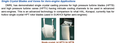

DMRL has been experimenting with Al-31's nozzle & turbine blades for quite some time now. Infact, 5-6 years ago DMRL had produced & tested DMS4 alloy single crystal blades for Al-31:
Combine these blades with YSZ-LZ thermal barrier coating you have TET capability of 1740+ K. This around the same TET that the 117S engine has.
This is doable is a fairly reasonable amount of time. Most of these aren't upcoming tech, these have been produced in limited numbers & tested already. Only question is if IAF is willing to invest.
