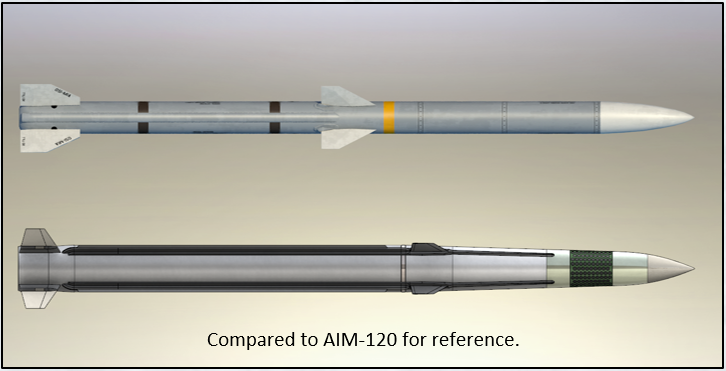

You are also mistaken with the date of the 260
This article from 2017 quotes the General. So the missile was already in the works by then.
In 2017, US Air Force General Herbert "Hawk" Carlisle cited the Chinese missiles in a call for a new, longer-ranged missile that would allow the Air Force and Navy to "out-stick" the PL-15.
“Look at our adversaries and what they’re developing, things like the PL-15 and the range of that weapon,” Carlisle said in a speech at the Center for Strategic and International Studies in Washington, D.C., on September 15—the same day that China reportedly test-fired the PL-15 for the first time. “How do we counter that and what are we going to do to continue to meet that threat?” Carlisle asked rhetorically.
The very next day, Flight Global magazine published an interview with Carlisle in which the general doubled down on his worried tone. “The PL-15 and the range of that missile, we’ve got to be able to out-stick [sic] that missile,” he said, using an
Air Force term for “out-shoot.”
The “outsize” missile probably is the AIM-260, which the Air Force and Lockheed Martin LMT +0.6% have been developing under a highly secretive program that began in 2017. There are hints the AIM-260 could range twice as far as the Raytheon AIM-120, currently the Pentagon’s farthest-flying air-to-air missile.

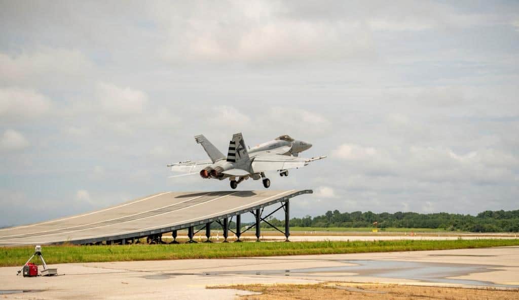

6-7 tons apart from fuel is beyond stretching it - just not feasible without catapult.
The maximum ASM load that Rafale was supposedly qualified from SBTF was a single AM39 on the centreline - and that's only a 670kg missile - two 2000L DTs on inner wing stations and 4 AAMs. Broadly that's <5 tons payload. Mind you we don't know how much internal fuel its flying with, probably not much for a strike mission (planning to rely on buddy refuel after takeoff).
"...As part of demonstrations of ski-jump launches with meaningful weapons payloads, Livefist learns the F/A-18s will be flying with two dummy Harpoon missiles — an attempt to show up the Rafale’s ability to only deploy one comparable Exocet anti-ship missile on its centreline hardpoint..."
We have seen this config flying:
The SH supposedly can pull off a similar load but with 2 x ASMs (Harpoons) - though we haven't seen any pictures of that config flying yet. So far the only pics available are with 2 x drop tanks and 2 x wingtip AIM9s.
All in all, I don't see it being very feasible to carry anything other than PERHAPS a single Brahmos-NG on the centreline of either jet. Which then raises the question isn't it better to go with 2 x or more subsonic ASMs (which will stack with every jet in a strike package so 6 planes can deploy 12 ASMs instead of 6).
From future CATOBAR flattops Brahmos-NG would make sense but from Vikrant/Vikramaditya not so much.
