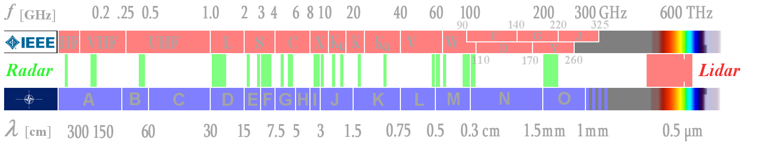

Ku band seeker is AESA and 99% fighters in the world do not have ESM to detect a KU band transmitter nor do they have jammers for this band. The jammers are equipped to jam frequencies in 1Ghz to 18Ghz. Ku band is way beyond that. Plus with a very short wavelength, KU band seelers have far superior target discrimination and near optical quality radar image. These guys in Hyderabad are doing a job which is known to very few in the world.

Ku band is 12-18GHz. So all current aircraft jammers have the ability to jam this frequency. What you are referring to is the K and Ka band which go from 18-40GHz.
You got confused with NATO K band. which is 20-40GHz.
I think you got confused. I referred to new designation and that is the NATO one. KU means-Kilo Band Under as it has two parts, KU and KA. Ka means-Kilo band above.
Ku, K and Ka are IEEE bands. Anyway, Astra's seeker is in the IEEE standards Ku band, ie, between 12 and 18GHz.
Under NATO's old name, there was no K band, only Ku and Ka, and in that Ka was 11GHz to 20GHz.
