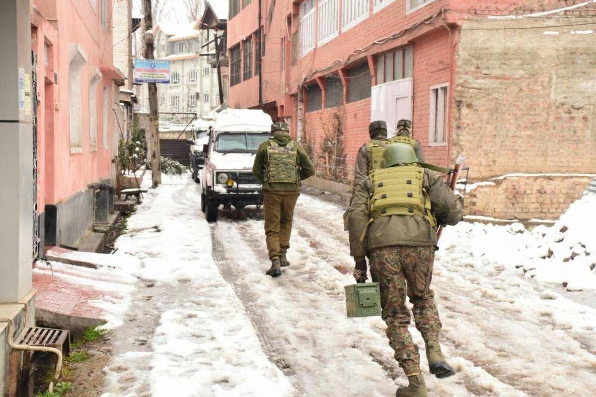

2.The new bulletproof jackets coming this year.How much can they impact our casuality rates?Particularly against ak-47 bullets?
Point to note is that a lot of CI/CT operators in J&K today (including Army & CAPFs) already have bullet-proof plate inserts in their Fighting Load Carriers (FLCs). However, it is not known to me personally what is the armor level rating of those plates. So hard to say how much of an improvement the SMPP vests will provide with regard to the HAP (Hard Armour Panel) sections...however, the SMPP vest will also provide SAP (Soft Armour Panel) inserts for the neck, groin & sides - which we don't have at the moment. So IMO, the improvement in protection standards (whether from bullets or shrapnel) will be most noticeable in those sections of the body.
main-qimg-1deafa7774008285ee650c7d3bc35b88-c
CRPF:
Still, there are examples where the FLCs can only accommodate a plate insert on the back and not in the front, plus, the bulk of the regular Army (whether frontline or not) still doesn't have BPJs. So the SMPP vest will show a marked improvement especially in those use-cases.

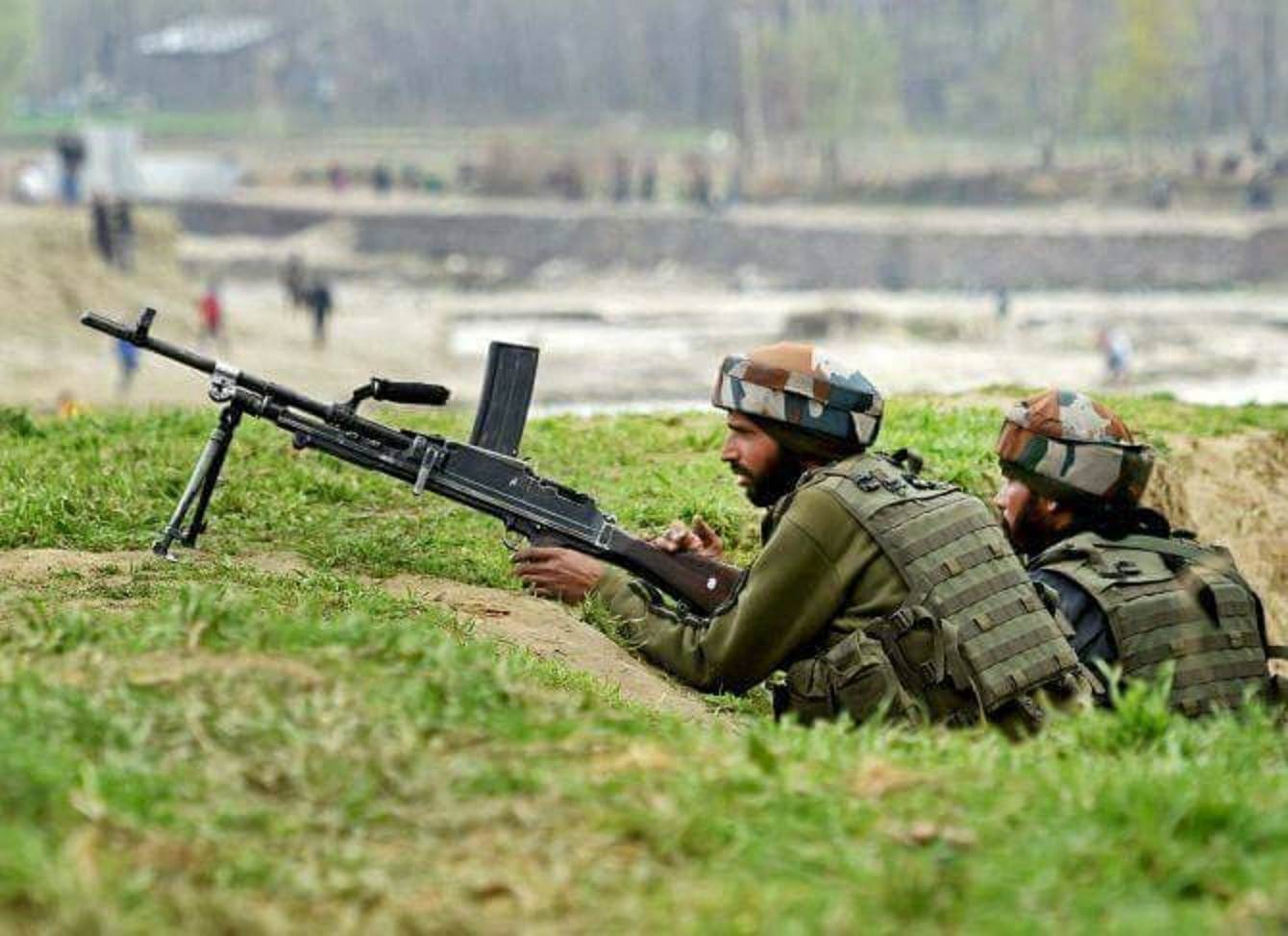

6.What kind LMGs do we use in COIN?INSAS LMG ,which probably sucks?Does the army not have a machine gun(even MMG) in COIN which can penetrate building walls?
RR uses both Bren and INSAS-LMGs. Para SFs use PK variants in their ops, while IAF's Garuds have the Negev 5.56 version. I believe I've seen some OFB-made MAG clones with stocks as well.
The Bren owing to its larger calibre is the most powerful cover-penetrating LMG commonly accessible to RR troops. Probably why it's still in service to this day. But then again, any AK is a devastating weapon when it comes to destroying cover or going through walls. So that's not what we need LMGs for. Their principle use is in suppressing/pinning down militants with sustained fire (at least as much as can be managed by the magazine-fed Brens and INSAS in the absence of a belt-fed gun) without having to worry much about barrel overheating & cook-offs.

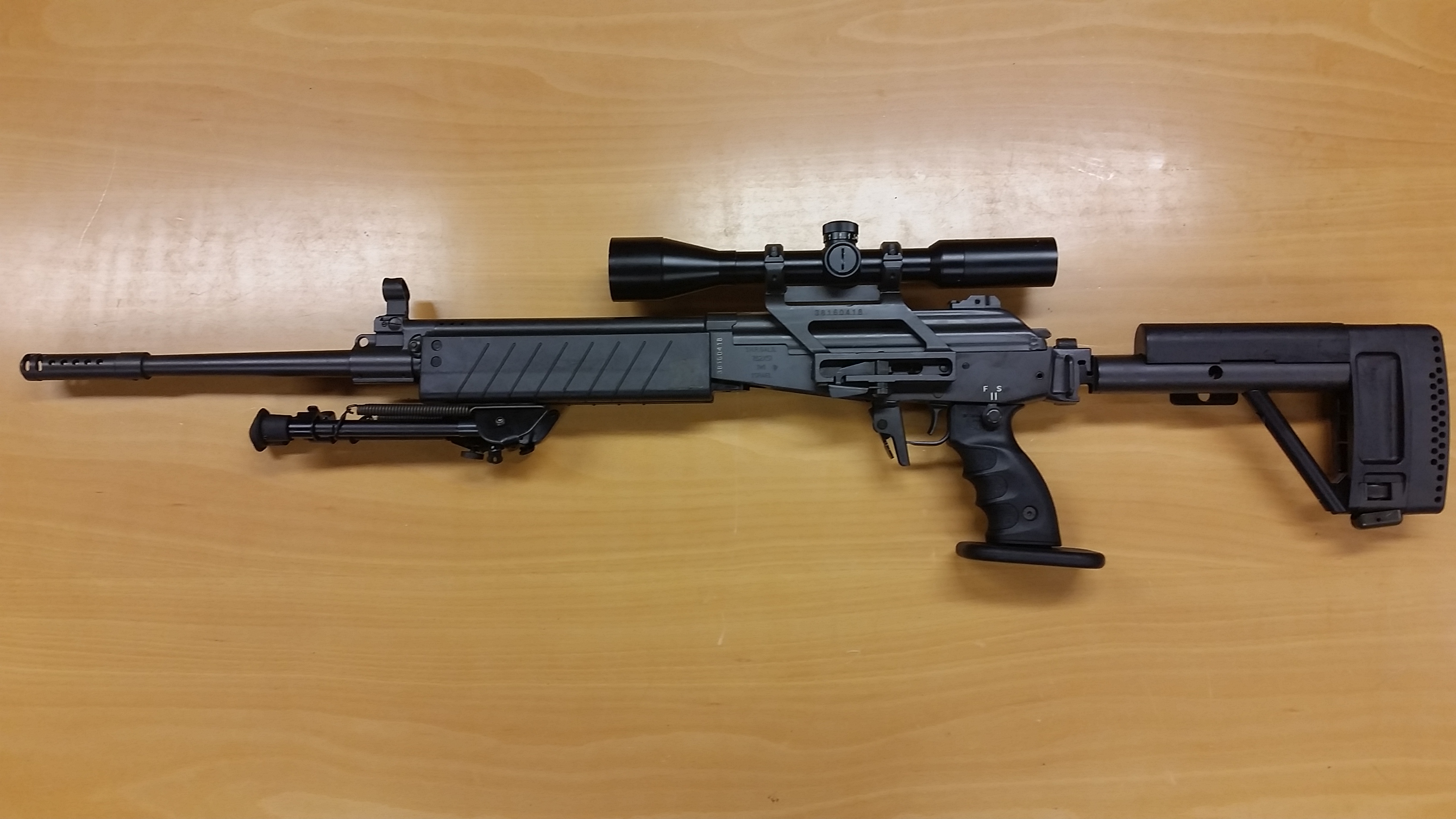

Indian Navy MARCOS Marksman with a Galatz 7.62mm NATO Designated Marksman Rifle/Battle Rifle with a Nimrod 6x40 Scope and a fixed Bipod.
Curiously the stock does not seem to be the wooden stock that the Army uses. What is that stock @Parthu ?
Also, what is that oval thing behind him ? Some kind of radar ?
What he's holding there is the newer variant of Galatz/Galil Sniper, which has polymer furniture. The stock is the standard one that comes with this model.
The one with wood isn't produced anymore. As far as I know, the polymer Galatz is standard for MARCOS, and only the Para (SFs) are still seen with the older wooden-furniture variant:
I don't have the pictures to prove it but I remember that recently I seem to have registered in my mind that Paras also started getting the new polymer Galatz. The older, heavier wooden-furniture variant might already be on it's way out.
Yes, the dome appears to be a radar. Though I wonder what is that hose leading to it/from it. Perhaps its just a heavily insulated wire.
