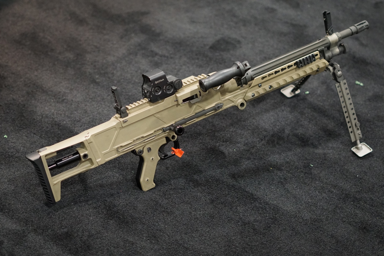

Possible contenders (only my opinion):
K12 from S&T Motiv (South Korea), already pictured in the tweet, though the pic is of a helicopter gunnery variant rather than the dedicated infantry one with a fixed stock:

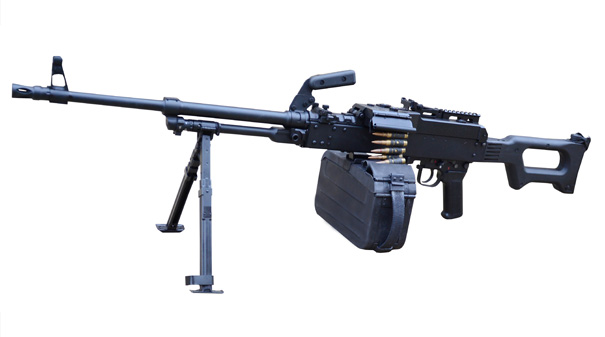

MG-M2 from Arsenal (Bulgaria), basically a PK converted to 7.62 Nato:

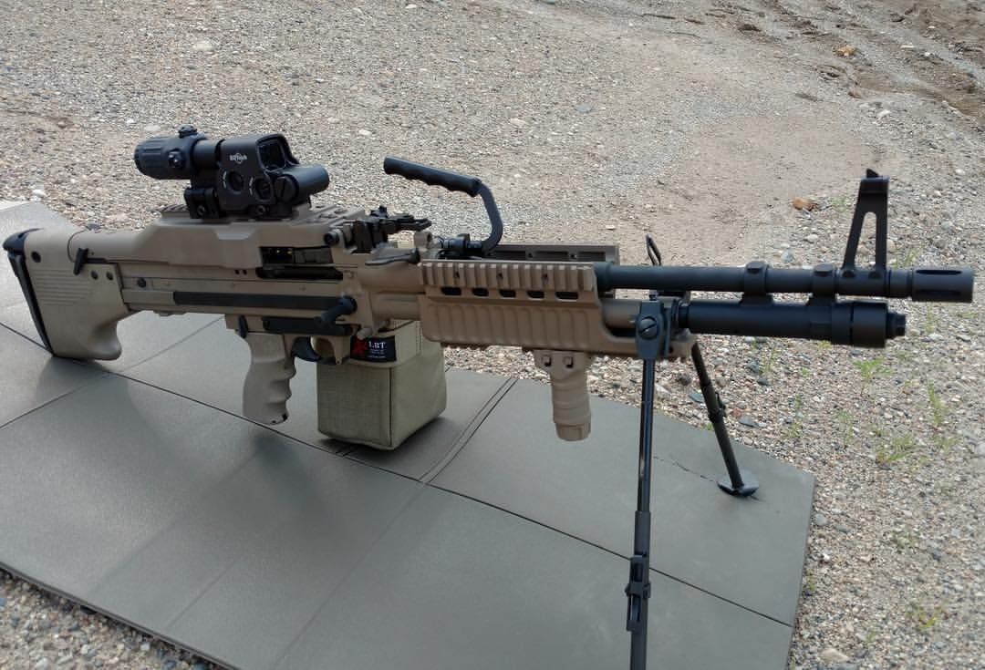

M240LW from Barrett Firearms, the lightest M240 variant so far:

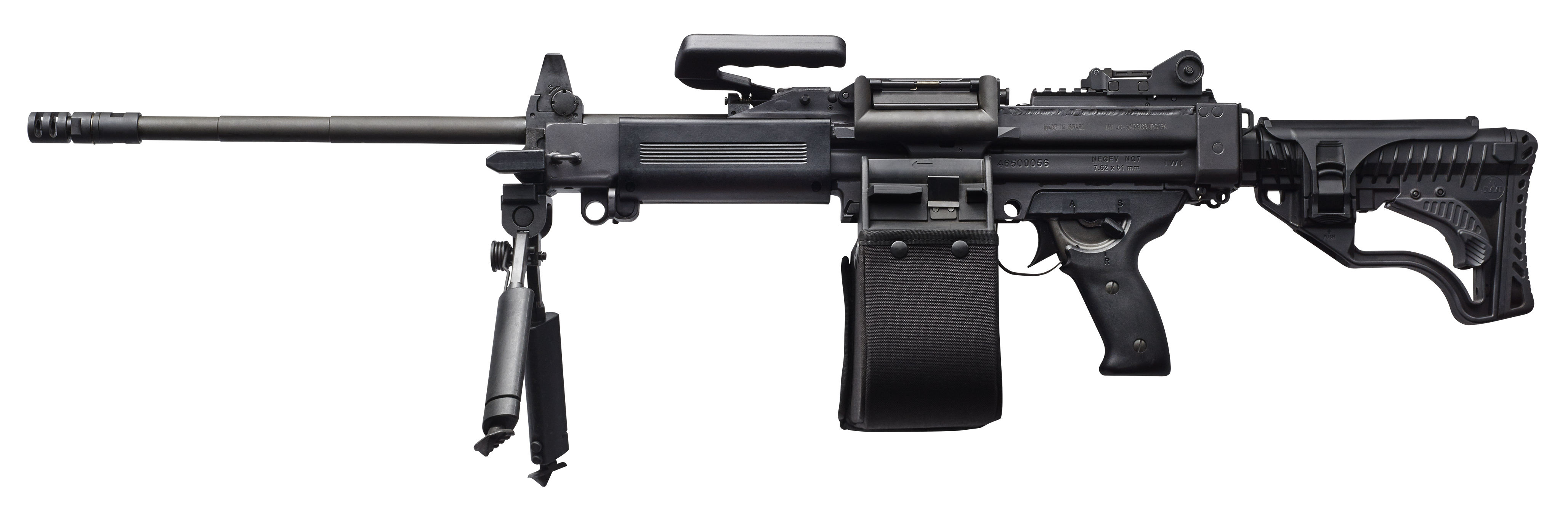

Negev NG-7 from IWI (my personal favourite among this lot), again not hard to check these out in the US itself (if not even locally in India via PLRS Pvt Ltd), besides we've already trialed this gun and found it to be the only qualifier in the previous tender for LMGs. Also, Special Forces units in the country already use the 5.56 variant of the Negev (Garuds, SG):

  • The NG7 (or the NG7-SF with shorter barrel) is the lightest one here. When we're looking to use a 7.62x51mm weapon as an LMG, I would think weight is most crucial factor to watch. Except for the NG7, I fail to see any of the other guns here as LMGs....every last one of them was meant to be a GPMG/MMG, and it shows in their respective weights*.
  • Two of the possible contenders in my book (K12 and M240) are FN MAG-based designs. The same MAG from which OFB's own 7.62 LMG is derived from.
K12 Infantry variant -- 10.1 kg

M240LW -- 9.2 kg

Negev NG7 -- 7.9 kg (7.8 kg for SF variant)

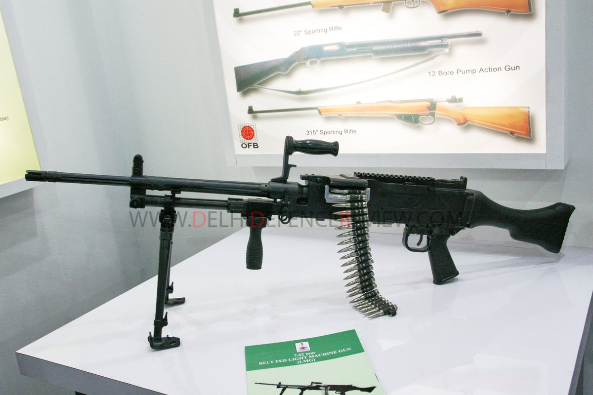

What's surprising to me is that the claimed weight of the OFB LMG is only a little heavier than the M240LW! The LW, as one can see, has undergone quite a lot of re-design and re-engineering by Barrett in order to shave off weight, and it shows in the design.
^^ The indented lines on the receiver indicate they did trim away a lot of material (similar to the technique used on LW). OFB brings this LMG in at 9.5 kgs.
What happens to the OFB LMG ?
It's still in trials as far as I know. But anyway, this deal is only for a small batch of emergency orders (fast-track purchase). The OFB 7.62 LMG is still likely to fill the bulk of the requirement separate from this. Although, for the sake of the shooters involved, I'd personally prefer it if we give IWI-Punj Llyod an order to build NG7s for the rest of infantry as well. The OFB LMG is a great replacement for existing MAG 2A1s in the MMG role...but for heaven's sake, I can't picture that as a squad-level LMG.
This is not to say the soldiers can't carry it - they can and they will. But it adds to increasing their fatigue and reducing overall physical effectiveness. Lighter is always better. Less weight the weapon is, more weight they can carry in other things (like more ammo, more provisions etc.).
I would doubt accuracy, service life, overall ergonomics and quality of OFB made guns. But, I wouldn't doubt the weight. As was mentioned by Sandeep Uninathan in a youtube video, OFB did do a lot of work on the weight department of the gun.
I'll just leave it here in case you missed it.
Largely agree with that. NG7 is an excellent choice. I do however wounder about that barrel length, seems a bit too long for my taste.

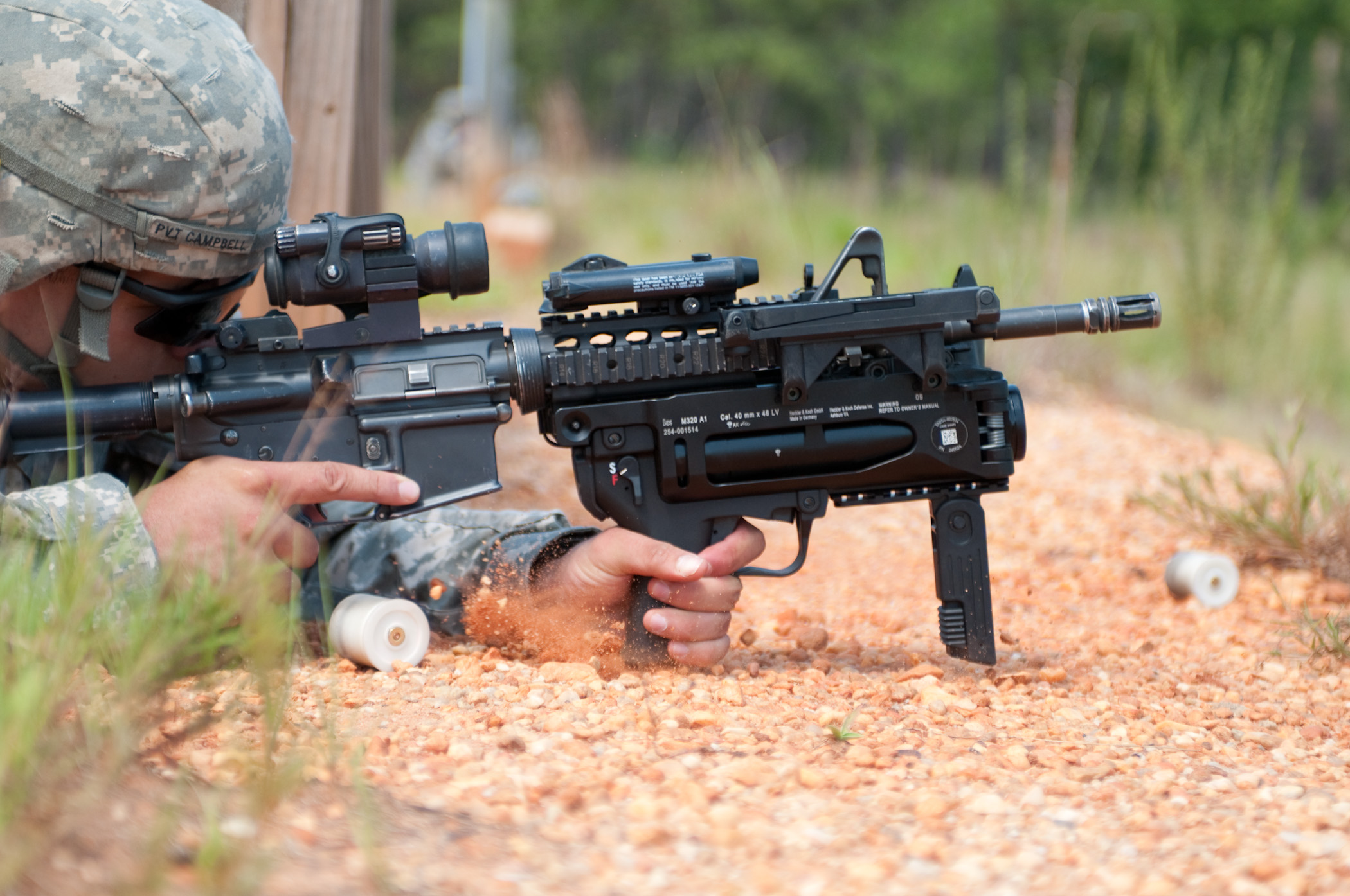

Regarding the grenade launcher, the OFB-made UBGL as it exists requires removal of the lower handguard on all rifles that it seats on (whether its INSAS or AK) -
As you said, it's not impossible for OFB to come up with an AK-focused UBGL that has a similar interface system as the GP-25/34 series (as the Vietnamese have done). So far the OFB UBGL has only been INSAS-focused, but with AK-203 coming in as replacement infantry rifle, I'd wager OFB will definitely come up with a launcher designed with it in mind, preferably one that mainly relies on Picatinny rails for seating, instead of latching onto the barrel/receiver** That way, we can also use the same UBGL on AK-203/CAR 816/SIG 716 - all without any handguard removal on any of them.
** Like the HK M320:

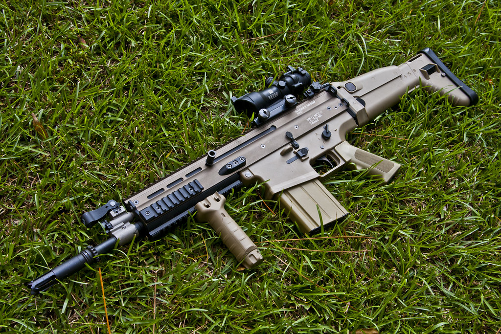

The shopping list includes 715 Mk 48 Light Machine Guns (LMGs), 1,050 FN Scar (H) 7.62x51 assault rifles, 1,400 FN Scar (L) or HK-416 assault rifles, 110 .50 Cal Browning heavy machine guns (HMG), 400 helmet-mounted night vision systems, 600 combat free fall parachutes, 100 Barret M107 A1 heavy sniping rifles and 20 million rounds of ammunition for all of these small arms. The proposals are part of fast-tracking of Para-SF buys initiated after September 29, 2016, cross-border raids on terrorist launch pads in Pakistan-occupied Kashmir (PoK). It is the most comprehensive re-equipping of the Para-SF in over two decades.
Indian Army’s SF units drew the list based on evaluations done after joint exercises with the US Special Operations Command (SOCOM). Each acquisition fulfils a critical void. The .50/ 12.7 mm HMGs are meant to be fitted on the Light Strike Vehicle (LSVs) being procured from Pune-based Force Motors over the next three months.
The 7.62 x 51 mm FN Scar, made by a US unit of Belgium’s FN Herstal, is required to upgrade the firepower of SF operators in dense jungles of the Northeast and Myanmar. The case for a new lightweight belt-fed 7.62 x 51 machine gun to replace 50-year old OFBmade ‘1B’ LMGs, has been pending since 2005. The LMGs are critical squad support weapons giving the small six-unit teams of the Para-SF units heavy firepower.
In their absence, SF units resorted to stripping machine guns from de-commissioned battle tanks or using weapons recovered from militants.
...the ad-hoc MGs they're talking about here are the PKM/PKTs taken from retired T-55 MBTs and/or captured from slain terrorists (they also include the Chinese copies of the same). Without discounting the merit of the weapon (PK is an excellent gun), it's quite appalling that the top SF units of a $3 trillion economy have to scavenge weapons from the field because they're not provided what they want. It's frustrating just to know, to be honest - however this bit itself about the PKs is not new to me or to many here.
The Mk.48 Mod 0/Mod 1 would make for an excellent squad-level MG in 7.62 Nato, the particular variant (Mk.48) was developed out of the FN Minimi (aka M249 SAW) keeping requirements of the US SOCOM in mind, I'd think it would serve the Indian SFs very well:
The SCAR L is a very real possibility as a replacement for the 5.56 M4A1s (I said as much in this thread a while ago), however, I have doubts regarding the buy of HK416. Now, it's not impossible to imagine HK416s making their way to India as in an FMS deal, it's the US DoD which places the orders and Heckler & Koch has no ban on selling to the US DoD, however, the Germans have very clear rules regarding end-users...

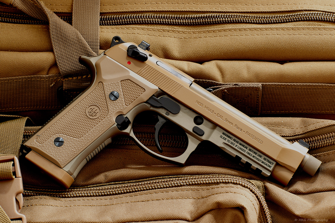

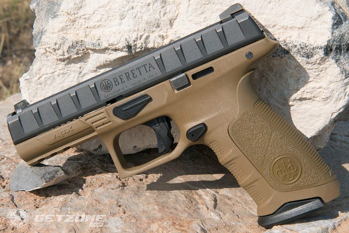

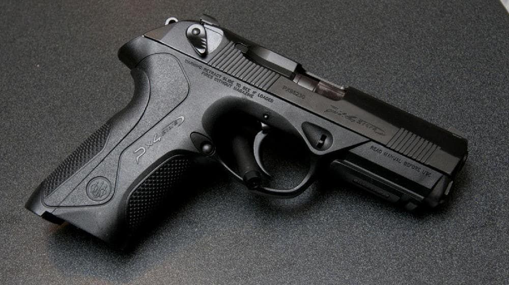

They do not specify which is the Beretta handgun being bought...I would think, there are 3 options from the company:
Px4 Storm
M9A3 (latest iteration of the 92FS which some Paras use, the "M9" designation was originally only for the US military-issued 92FS, but later on, Beretta started naming its 92FS successor model as M9A3 internationally...or at least that will be the case as the model was specifically developed for the MHS competition. It's not to be ruled out that it will acquire a different name for the international market now that SIG won that competition. But till then, we have no name to refer to it other than as M9A3:
APX (my personal favourite, don't ask why...it's also the only striker-fired pistol among these three)

6.What kind LMGs do we use in COIN?INSAS LMG ,which probably sucks?Does the army not have a machine gun(even MMG) in COIN which can penetrate building walls?
Usage of LMGs in COIN largely depends on the terrain of the warfare.
If its a semi-urban environment with brick walls, lots of corners, doors, windows etc I would recommend not using LMGs at all. These environment demands mobility and LMGs would kill mobility. Maybe you could use a NG7 but anything heavier is best avoided.
If its a jungle mountainous terrain then something like a PK GPMG will do just fine. We do use those.
