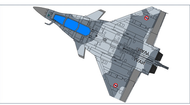

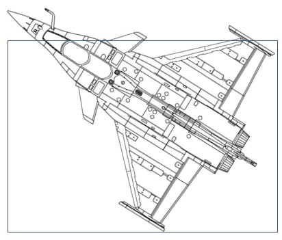

Right, the lift itself is just 10m wide, so it won't go through anyway.
The Rafale without its wingtip in the Viki's lift Drawing to scale

It reduces the length of the aircraft allowing more aircraft to be carried in the hangar.
I think you have to close & open radome manually, it will affect aircraft's swift deployment.
Also electronic equipment is exposed to outside moisture content, and what will happen if you are lifting the aircraft to deck while radome open during rain ? You can't avoid lifting aircraft during rain when requirements arises.
@Picdelamirand-oil how will you address these two issues?
1)How will you lift the aircraft during raining with an open radome?
2) how much time it will take to open & clossing the radome manually? I believe you have to tilt radome manually, f18 & mig29k folding wing is machine controlled and it will not take much time.
It is not obligatory to open the Radome in order to use the lift, but if you don't open it you have to be very careful about the position of the plane and in the end it can take longer than opening it.
So we open it in good weather and leave it closed in bad weather.
The opening and closing is designed to be fast, less than 5 minutes in total, and it can be done at the same time as you fix the weapons under the wings.
Likewise the assembly and disassembly of the wingtips, which is similar to the assembly and disassembly of the pylons under the wings, can be done in hidden time.
Have you ever seen what it's like to make a pit stop in a Formula 1 race: it must be similar when you operate a Rafale on an aircraft carrier.
Area used by an F-18SH: 18.31 * 9;3 = 170.3 m2
One Rafale : 15.3 * 10.9 = 166.8 m2
An open nose Rafale: 14 * 10.9 = 152.6 m2 and the Rafale can be put head to toe.

How are they going to push the aircraft in that way?
I think if both carriers operate Rafale, then both will carry 6 or 8 each and will be placed on the deck rather than in the hangar. Only in case hangar servicing is required, they will be taken in.

On the Vikrant, the lifts are lateral (like those of the Charles-de-Gaulle) and measure 14 x 10 m, it is a little small but planes can overtake on the sea. The nose of the Rafale can overhang the sea by almost 5 m, which makes it possible to put the wings almost in the length of the lift and to keep the wingtips. In addition, one of the two wings can also overtake.
